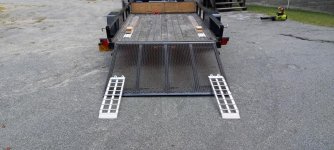

Here's one of the many solutions to the age old problem of the frunk hitting the ramp, and bottoming out on the way up and down, if you have a conventional landscape type trailer.

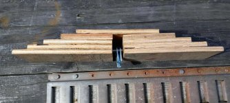

Looks decent. I presume the blocks inside the trailer are to help prevent bottoming out?

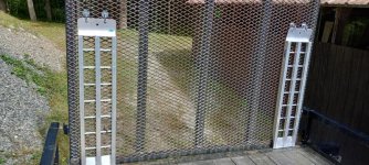

Yes, and they clip into the e track to hold them in place. Also the ramps are attached and they make it easier to raise and lower the tailgate.
