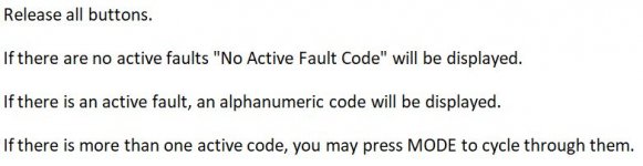

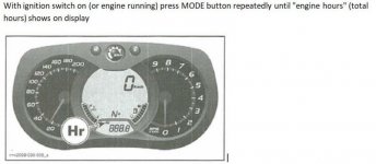

Fault code recall for 2010 RS
The following is the fault recall procedure for a 2010 RS. This will only work for active faults.

Sorry Phil. Thank you Billy. There was a little voice in my head that an RS was different. I should have listened. Removed bum dope from previous post.
