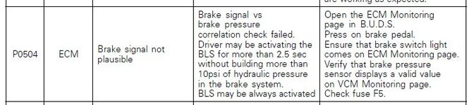

There is a specific code for riding the brake, so you should be able to confirm or rule out that as an issue.

occurred: P0504: brake signal not plausible.
" " : P0556: brake pressure on CAN not valid.
