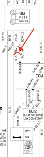

I found a video and have a document on how to disable the DESS on a 2010 RTS SE5 - and I found the connections!.... I have a new keylock mechanism coming with new keys so I want to disable DESS ... to use the new keys as there is no dealer/service to program it... and I really don't care about DESS, anyway...
Question is : Will I need to connect the antenna on the new key mechanism is the DESS is bypassed? The DESS bypass is pretty straight forward.... has anyone done this?
Here is the document I have shared on Google drive
Yeah, one of your fellow country-men posted a video in both English and French on this about 4 years ago. I assume that's the one you are speaking of. Never did it myself, but even your written write up says that the DESS antennae is not used. So, don't use it. I don't believe that anything actually needs to be reconnected. Just jumper those two wires together and you're good to go. Although, I believe in that video, if we're looking at the same one, he did it slightly differently than the written write up, he disconnected everything, and connected the Beige and Black/Yellow wires together. Bottom line he figured out, is simply that the early DESS system simply runs the Kill Switch through the DESS module. He bypassed the module and jumped the switch right to the ECM, and voila. Works.
