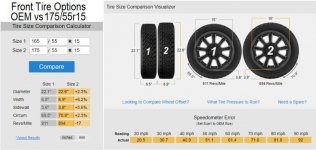

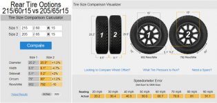

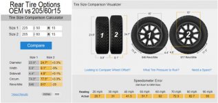

You can get the Vredestein HiTRAC, (the tire that won this 4 tire comparison) in a 205/65r15 which will fit the back of the Spyder. You lose about 3/4" of width from the OEM. But many are running this size tire in the rear and are happy with it. It is about 1.25" taller. Which will help your speedometer accuracy.
Information I've read and have also talked to the people at Tire Rack is that the 43 and 45 are about the same in all aspects except that the 45 is slightly better in dry and wet than the 43 and is supposed to get a bit better mileage. The improved mileage is extrapolated from the 'Temperature' rating which is a 'B' on the 43 and and 'A' on the 45. This is a measure of how well the tire resists heat buildup and how efficient it sheds that heat. Less heat. longer life. I don't think this will be as big a deal on our light Spyders as it would be on a heavier car.
There was a change in the tread pattern on the 45 which is what they attribute the slight improvement in handling and traction to. But the compound was unchanged.
Head-to-head with the tires that fit our Spyder. I have not found a tire that rates better than the Altimax in the 215/60r15 size.
The Altimax does not come in sizes for the front. We have been installing the Vredistein Quatrac in sizes 165/60r15 and 175/55r15 for the front. Again, against other tires that fit, we have not found a better tire than the Vredestein Quatrac. This is not to say other tires are not a viable option. But some vendors are selling left field, no name tires. They are untested and I fear, not very good at all. But they are cheap and they fit. Customers trust us to do right by them. It is important that we earn, and keep that trust.

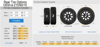

With a 215/60R15, the 215 is the Nominal width in mms; the 60 is the Nominal sidewall height expressed as a Percentage of the width in mms (ie, 60% of 215 mms, which is 129 mm); the R means the tire is a Radial tire; and the 15 is the rim diameter in inches. :thumbup:
Here are some visual tire size comparisons. These are industry standards which not every tire will meet. In other words. Depending on the individual tire. It may be a bit wider, slimmer, taller or shorter than these dimensions. Though it should not be by much.
This Tire Size Comparison chart has been posted before. It is a very handy tool when shopping tires for just about anything.
https://tiresize.com/comparison/
