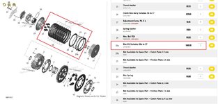

OH MY! I didn't reply to this one because I figured you'd have plenty of info from others. Sorry.
First, your parts guy is a... Well, no, I won't say it. Look at the screenshot below. You have to get the full clutch kit, which is readily available. You can't purchase the components individually. Nor do you want to, in this case.
I do not know of any aftermarket clutch kits for the 1330. There may be some cross fitment from other Can-Am products. But you'd be taking a big chance going that route.
As I've said many times. If you don't know more about your Spyder than the dealership does, you may be in BIG trouble! Should it be this way? No. But that truth will do you no earthly good.
Make sure you get the right clutch kit. There is one for the SE and another for the SM. They are not interchangeable. So, this problem is solved. But you have to wonder, if the parts guy can't find it, will the tech know how to install it? That's another hurdle.
