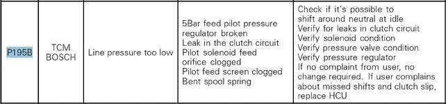

I just noticed a code of P195B
Line Pressure too low
UPDATE: Had the Spyder towed in to the dealer this past week. They hooked it up to BUDS and found several codes. The tech also took it for a ride and did experience shifting issues. They put together a list of issues and sent in to BRP. Now we wait to see how they want to proceed.
NOTE: This bike NEVER threw a check engine light related to the codes. So it’s probably a good idea to go in to see if you have any codes in the onboard computer that are not throwing a check engine light. Could save yourself a lot of aggravation.
