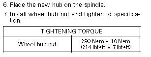

Not sure if it is the same on the F3
Thanks for the copy. I found 122 ft*lb in my 13 ST manual and thought it was high. 214 is even higher!
