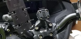

I used the mounting hardware that came with the XT. The dealer mounted it and wired it at no charge before I picked up the RTL. Seems to be a good location and I don’t have to look down.
