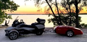

I took this photo of a hitch that is fitted on a Lees-ure Lite trailer and has been tested for thousands of miles. The the trailer is pulled by a Spyder and it really makes a difference in the bounce created by the hitch being mounted through the axel. I pulled an Aspen with my RTL for over 50,000 miles and had to reinforce the Tongue twice. My son and I are going to make one for my new to me Lees-ure Lite that I just purchased for our trip to Fairbanks via the Alcan that I figure will be full of potholes. We may have to wait till next year for the trip as I have a feeling the borders may not open till late this year.

:clap::clap::clap: .... I love a fellow " DIY'er " :thumbup: .............. Mike :ohyea:
Big and bulky looking but looks like it should really help soften the bounce and shock imposed on the trailer tongue. I can attest to the need for reducing the bounce. I unknowingly pulled my trailer about 300 miles with only about 3/4" wide piece of 0.60" thick metal pulling it after the tongue cracked almost all the way around.
I wonder how well a rubber torsion bushing would work. You know, like what are used on trailer axles.
Here are some torsion units that probably would work. https://www.lovejoy-inc.com/products/runright-rubber-suspension/runright-product-technology/. I'm tempted to convert my trailer tongue using one of the RSS units shown beginning on page 50 of this catalog. https://www.lovejoy-inc.com/wp-content/uploads/2019/10/RunRight-Full-Catalog.pdf. I think the advantage of a torsion busing would be the trailer tongue would have a pivot point not much larger than the tongue itself.

I've owned a few of the top tier trailers and I figure my Tailwind will be my last trailer. One of the reasons I purchased the Tailwind trailer was the suspension spring supported hitch design. To me, it helps significantly to help stabilize the up and down velocity.

This is intriguing. Any thoughts on how much actual travel vertically is a reasonable amount to be effective?
Looking at the ones shown, seems to be 2 inches or more.
When the weather warms up here I think I might take my trailer out for a spin with a GoPro videoing the tongue. I'd like to get a better idea of just how much the hitch and trailer each bounce. I'm guessing it's only about an inch, but it is a hard and fast bounce, more like a vibration.
