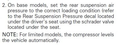

Can't find my hand pump and want to buy a new one. Not sure if I need one that maxes out at 60#, 100# or 300#.
Look under the seat for a decal.
50-60 lbs for a typical 1-up with relatively light loads in bags.
According to the sticker the max recommended pressure is 85psi. The label further says, "do not exceed maximum recommended pressure by more than 10 psi."
So the most you ever can use is 95 psi. Solo, I like mine at 52 psi.
Thanks. What weight? Solo or w/a pillion? I'm 300# but won't have much luggage or a pillion.
I'm 240 and don't routinely carry a passenger, and I run 54 pounds (cold/unladen). Also, there's a dealer notice that indicates that it is common to loose 4-5 pounds of pressure per approximately ten days at higher pressure settings. Also, I used a valve stem extender (used on trucks with dual wheels) to make adding air pressure to the rear shock much simpler.

Right off the sticker, it recommends 60# for your weight. (rider 250# (55psi) + 50# (5psi))
That's a good starting point, but you'll have to experiment. The Schrader is a bugger to get to.
