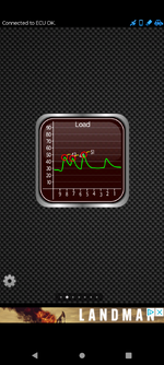

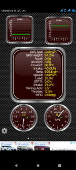

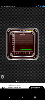

I haven't posted it yet because I didn't want to steal this person's thunder but there is an adapter you can buy to hook up an OBD II Code Reader and read a good bit of the Can Bus info on 2020+ machines.
He is getting ready to post up info on it on facebook in the F3 group and I asked him to cross post it here when he is ready. No, you can't read BUDS codes or do anything that BUDS does as far as programming or resetting codes, but you do have access to a whole plethora of other info.
https://www.facebook.com/photo/?fbid=10234454129193899&set=gm.3859664044308450&idorvanity=1895542614053946
I have ordered one of the adapters to try it out with torque to see what I can pull up and the adapter is only about $13 US.
