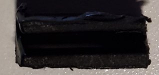

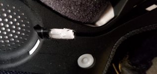

All you need to do is cut out a small ~1" piece of the hard plastic liner in front of the left speaker cutout. I'll attach pics of the piece I removed and an after shot of the cut out section. Once you do this, you can plug in the boom mic and hook everything up like you would using the original SRL.
