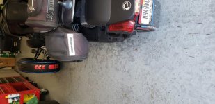

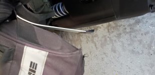

To support my soft bags, I went to Lowes and just bought a strip of metal was 2 inches wide and about a yard long. I slipped it through my Max Mount. I then just bent it into position. Keeps my bags off of the swing arm without issue. See picture.
Great idea. You said you slipped the strip of metal through the Max Mount. Could you show a more detail pic of how you did this and what department at Lowes did you find the strip of metal? How thick is it? Thanks so much!
