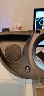

I got a set of decorative plugs to replace the gauges, I think from BRP!! :unsure: Some people use that space to put USB ports!
