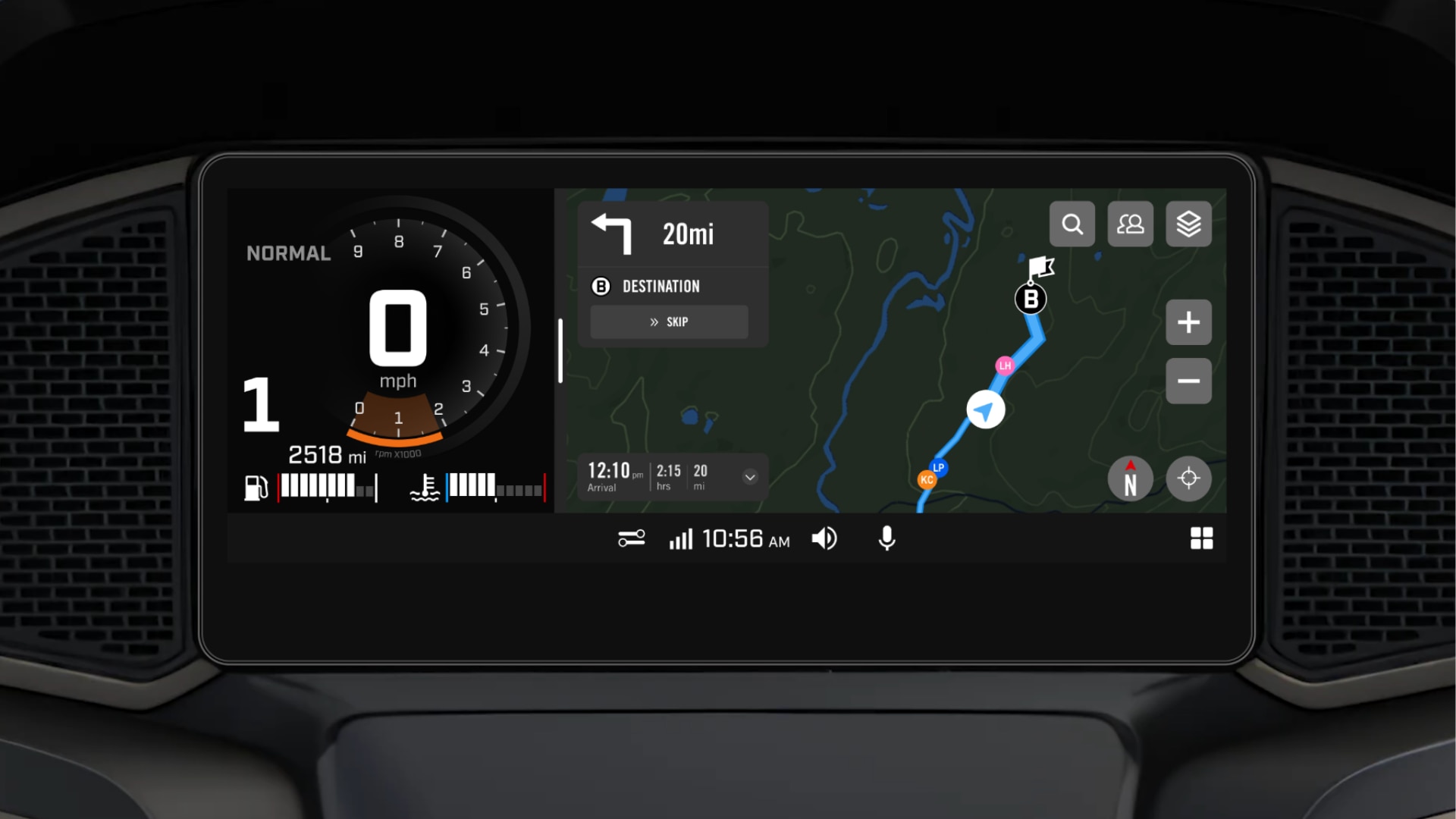

Updated my 2026 S2S today with BRP Go nav. Now there's no Apple Car Play ....not even the Icon :( It was replaced by the BRP Go nav icon.
Go into your preferences and scroll down to the navigation options.
Once there you will see a "on-off" toggle to activate or remove the BRP GO navigation as the default navigation option which will restore the Apple CarPlay icon on the main page after a screen reboot.
Thanks Slypx ! I was just playing around with it a couple of hours and discovered this . Was logging on to update . It was nice that you didn't have to turn off and on for it to reboot ......less then a minute
