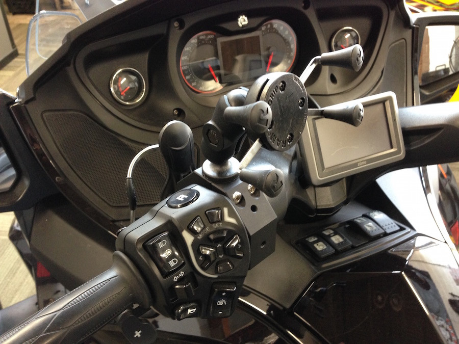

I have a 2014 RT and did not come with gauges on left and right sides so I used the right side for mounting my Zumo 590 GPS. I used short Ram mount arm attached to threaded ball. Locked it up on the cradle with KradleLock and Kapplock.
attachment.php
attachment.php
