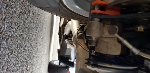

Hi all", I purchased a disc brake spreader tool and the job is done. Thanks to all who post here and Finless Bob too. Picture of tool used here,
Regards Peter:congrats:20181026_160424.jpg
If this tool worked I am very surprised that your C-Clamp failed you. A C-Clamp will put a lot more pressure on the caliper piston than this tool. Glad you got it fixed though. :thumbup:
Hi mate", I think the problem with C Clamp was I did not have it clamping down straight on the piston,
Regards Peter
