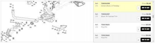

With that being said, I'm not sure how similar that part of the bike is to the F3 and F3-S but those models have trim parts available (see image). On the models that have them, they make the transition neatly to the rest of the contours of the body. Hardest part will be getting the foot pegs off. :cheers:
Hello, BRP makes covers for the rear pegs. Not 100% sure for the F3T but sure for the F3. Look at a parts diagram and you’ll find them. There’s a cover, sleeve, bolt, washer, and square nut. Study that LaMonster video, no joke.
