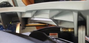

The OEM pot metal windshield lift arm is prone to failure. I've known for some time now that a stronger version, machined from a solid block of aluminum ("billet") has been made and sold worldwide by a SpyderLover in Australia who goes by "noboot" on this forum. So, I ordered one (AUS$160 including shipping) and it arrived within 4 days.
Ron (noboot) provides great instructions with his beautiful billet arm, along with a set of aluminum wedges needed to remove the plastic worm gear from the motor driven shaft. The mechanism, which is located underneath the dashboard cover panel, has to be removed from the bike in order to replace the OEM arm with the new billet one. To get at it requires removing the mirrors, front side body panels, headlight shroud, the windshield and the bracket to which the windshield attaches.
This project is a bit more involved than some others I've documented and requires an assortment of tools the casual D-I-Yer may not have on hand so it's a good idea to read and understand the instructions thoroughly to reduce the number of possible trips to the local hardware store for tools or little parts you've lost down inside the bike (I recommend draping a large cloth over the exposed work area to mitigate this possibility).

Removing the shaft from the bike
Before removing the shaft mechanism, clearly mark the alignment of the shaft, arm and hold down caps. Once the shaft is removed, observe how the magnet on the right end is oriented. Put a mark on it near the edge in line with the other alignment Mark's, so that you are sure the shaft and arm are oriented correctly because the marks on the shaft itself may rub off while working on it!
