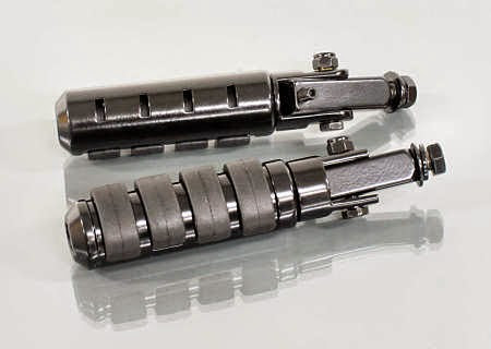

I purchased the RIVCO Black Highway Peg Mount Set (CAOO4-RTB) made specifically for the 2013 and newer RT with factory floor boards. I ordered the black powder coated brackets and pegs, because I thought they would look best with my Spyder, but these also come in chrome as well. Note that these are intended only for BRP factory floorboards, as the mounting brackets are cut to exactly match the forward outside curve of the factory boards.
The mount kit does not come with the pegs themselves - so you have to buy a set of pegs as well. The brackets will fit, without any modification, any highway pegs that mount in a 3/8" hole, which includes all RIVCO pegs, as well as many others. I purchased the RIVCO Anti-vibration pegs, also in the powder coated black color (PEGSBK). I purchased the mounting kit and the pegs from Value Accessories. (Both Value Accessories and RIVCO are currently forum sponsors.

Both the mounting kit and the pegs are rugged and very high quality. The mounts are bolted to the underside of the floor boards with hefty 3/8" bolts, washers, lock-washers, and lock nuts. They are extremely rigid when mounted, and the bolts fit nicely below the rubber pads on the boards. As stated above, the brackets are made to exactly align with the outside curve of the factory floor board bases. You cannot see the mounting plates when the job is done, except for the very edge of them. The kit provides a cut-out template that you lay out on the top of the floor board bases, and it tells you exactly where to center-punch marks for drilling. You don't even need to measure. Next you screw on the extender brackets to the mounts, using sturdy 1/2" machine bolts, washers, lock-washers, and a star-washers. That combination makes their position easy to adjust and holds them firmly in place when tightened. RIVCO says that these can mount in a variety of positions, but really the only position that makes sense is to point the extenders forward over top of the black plastic splash guards that are mounted on the RT in front of the floor boards. I tightened mine in a position about an inch above those plastic splash guards, so as to leave some room for the right break-away floor board to drop, in the event of hard braking in an emergency. (More on that later.) Then the pegs simply mount to the upper hole in the extension brackets. The entire installation procedure is extremely easy, and well documented with instructions. Here is a link to the installation instructions on RIVCO's web site.
Here are some pictures of the new highway pegs on my 2013 Spyder RT Limited, showing the pegs in both the extended and upright positions...
