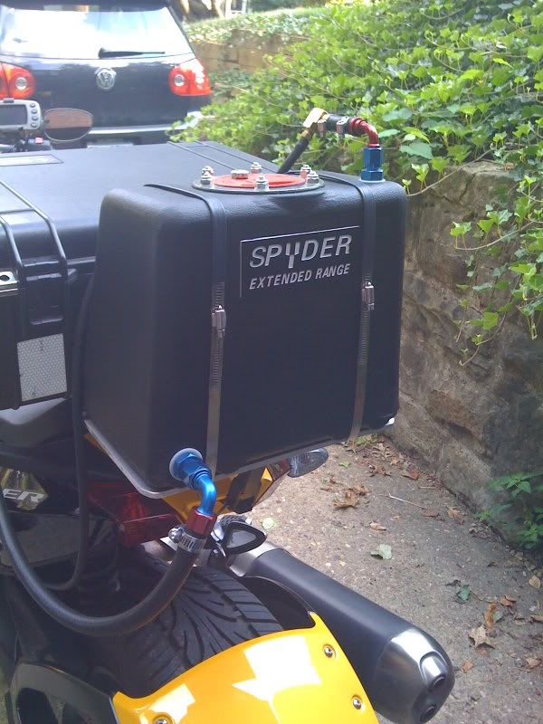

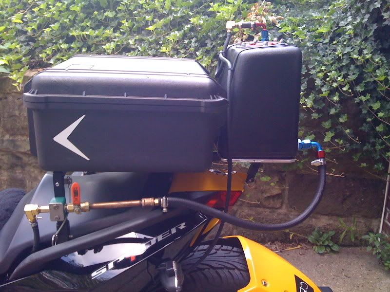

Stuart Ostroff is heading out to the "Very Boaring Rally" in Duluth, MN. I took these pictures of his 3 gallon fuel cell mod and thought the group would be interested. (He's too busy to post right now)
The cell is mounted behind a Pelican case that's mounted to a removable rack fabrication. The fuel from the cell flows via gravity through a modified gas cap when the fuel valve is opened.
