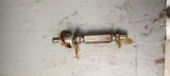

I have done many oil changes on my Spyders over the years and never had an issue. Today Murphy stopped by and stripped out the head of the transmission plug. I ordered the upgraded oil plugs from value accessories. I am hoping an easy-out will grip the plug enough to remove it. Those darn BRP engineers should be fired. Even an experienced mechanic can run into this problem.
Update: easy-out took the plug right out. It was very tight. I must have been extra strong the last time I changed the oil. All fixed forever now!
