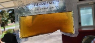

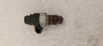

The factory recommended interval for brake fluid flushing is every 2 years. Yes, of course you can bleed the brakes the old fashioned way, one wheel at a time. However, there is no way to bleed the ABS unit without hooking up to BUDS/BUDS2. During the procedure, BUDS will tell you which wheel to do and for how long. It will then have you bleed the ABS unit. During this step of the procedure, BUDS will cycle the ABS unit on and off numerous times, getting all of the old fluid out and replaced with new clean fluid. I did a flush on a friends 2016 F3T today. The bleeder screw on the ABS unit has considerable corrosion and the fluid that came out is very cloudy, dirty, and contaminated with water. (Brake fluid absorbs water out of the air). Getting all this moisture out of the fluid will prevent corrosion in your calipers, brake lines, and ABS unit. Corroded calipers and/or ABS unit can prevent them from functioning properly, which means they might not apply properly or release properly causing dragging brakes.

I'm also guessing that Jetfixers bag is the total product from the whole system, some 7 years old as he says its from a 2016 but dosnt mention it been done since new.

The quick answer is NO. Just as in the calipers, the fluid in the ABS unit is trapped, and is simply pressurized and depressurized by stomping on the brake pedal to activate the ABS module. There is NO flow of fluid. And yes, the photo shows the collected fluid from all of the bleeders. But I don't know if this particular bike was ever bled before. It was bought used, without knowing it's history. My point is, if you only bleed the calipers in the traditional method, you will NOT know the condition of the fluid in the ABS unit. Since the ABS unit is installed as an emergency device, I would not mess around with it. You use your brakes every time you ride. How often have you felt the ABS unit activate? This is the device that lurks in the background waiting to save your butt. If you take care of it, it will take care of you.

I've thru to post #15, and learned a lot .... Thanks ..... That bag has all the fluid from the Spyder. Does anyone know how much fluid is in the .... ABS unit ????? .... thanks ..... Mike :thumbup:
I was wondering the same thing. I have read here it is a miniscule amount.
