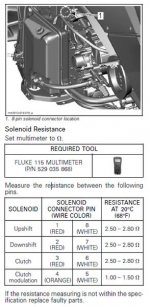

Did you test solenoid resistance?
I tested the solenoid resistance but I did it wrong. I'll re do it asap. I've been waiting for the new oil filter I ordered. It was supposed to be here Tuesday. I got it yesterday, Friday. Ticker's been acting up so I haven't been in a big hurry to mess with the bike lately. I plan on working on it tomorrow.
