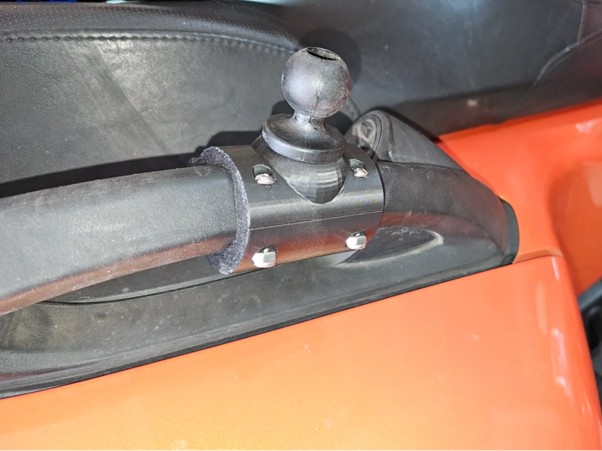

Here's my take on a drink mount for my passenger. I designed it myself after taking some measurements and looking through the ram mount parts I had on hand.
I have a 2019 Spyder RTL and it fits very well. I don't know if it will fit the newer models or not.
I tried 2 or 3 other methods for mounting a drink, but they always resulted in either spilling drinks, or tearing the padding on the handrail. This one is long enough and well fitted enough that can't twist or tear.
I designed it using tinkercad. It's a completely original design, not a remix. The one in the images was my PLA prototype. I've since printed it with ABS so it won't melt in the summer heat. PLA tends to get soft up around 90 degrees
Since I had a real RAM ball I designed the mount around using that. But if someone really wanted a fully 3d printed model with an integrated ball, it could be done.
