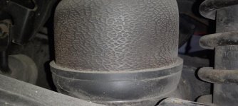

I am in the process of replacing my Air bag and compressor on my 2014 RTL. I have read quite a bit about the Air Bag Armour that was once available. I understand that it was a modified Fernco test cap. I have read conflicting posts, some stating that it is a 3" cap and some stating a 4". I have both. Can anyone who has one tell me the correct size? I would also like to hear from someone that has a number of miles with it installed. Is it worth the effort to install?

I have done several caps under the air bag jobs...I always used the Fernco 3" caps...You just need to drill a hole in the center and get a little longer metric bolt...Fits VERY SNUG on the bag...larryd PS A 3" cap is about 3 1/2" ID...
