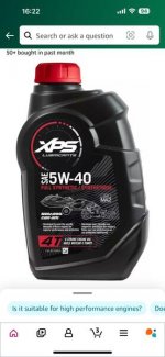

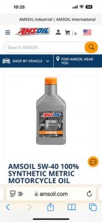

I think I'll try Amsoil. I know many swear by it, but I didn’t want to use it because of how it’s marketed...
Is a synthetic blend still the recommended oil by BRP for RS's or is it now either/or?

That said, I'm running this in my Spyder:
https://www.amazon.com/gp/product/B09C153FLW/ref=ppx_yo_dt_b_search_asin_title?ie=UTF8&th=1
I'm seeing much better oil pressure with the higher viscosity, but I'll probably go to 10w40 at the next oil change.
