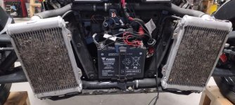

It can't look worse than this crime scene I found after I removed my trunk. After witnessing this I put insect screen in front of the stock grilles. That works really well but I think your idea might be better.

Yeah it’s almost like this filter stuff is just stiff enough to kill the bugs but not splatter. They just fall to th bottom of the filter along with rocks and road debris. They work great for cheap and homemade sort of
