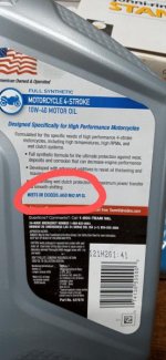

I use the Valvoline 4-stroke Full Synthetic Motorcycle Oil 10w -40 I have since 2015. I have have had any problems.
The Valvoline 4 stroke oil is formulated for the specific needs of high performance 4 storke motorcycles, including high temp., high RPMS and WET Clutch systems.
Full synthetic formula for the ultimate protection against wear, deposits and corrosion that can decrease engine performance..
Developed with advanced additives to resist oil thickening and maximize horsepower.
Outstanding wet clutch protection for maximum power transfer & smooth shifting.
Meets or exceeds JASO MA2. This oil is the gray bottle. I got my on line.
Deanna
