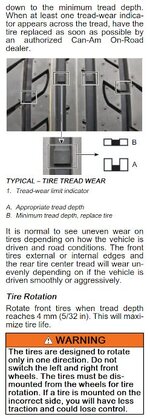

So, looking at the owners manual, they show the front tire tread pattern, which is what we have.
Only thing I can think now is once a direction is used, you should stay with that direction, whatever it may be?
Clear as mud....
*Edit* --> Ahhhh, that picture is there for the tread depth only.... I'm going with the idea of non-directional for the front.
Clear as mud....
I take a look at that picture of that tire, and it don't look like the same tread pattern that I see on my bike or the same pattern in post 16, looks different! Maybe I am looking at it wrong! Look at the pattern on the outside edges.
