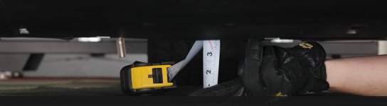

  • Adjusting Ride Height
  • Configure your Spyder for your average ride. 1-up, 2-up, average baggage, etc.
  • On a flat and level surface, have a helper measure from the bottom of the central frame member towards the front of that frame member to the floor.
  • Using the provided Red Spanner Wrench, if needed, adjust the spring preload so that, loaded as described in first step, the ground to frame measurement is between 3.5” and 4”.
  • Be sure to make the same, exact number of turns to each shock adjustment ring.
