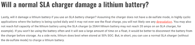

This is what PowerSonic, a lithium battery manufacturer, states. In short, a standard battery charger will work as long as it does not have a De-Sulfate process and you don't leave it connected when the charge is completed. Don't use a standard float (tender) type charger.
