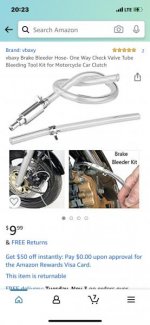

I’ve been looking at bottle with one way valve so I can insert the hose, open and pump without needing help but hose below with one way valve may be the solution.
Speed bleeder pretty much utilizes same idea, one way valve and it’s a permanent fix.
