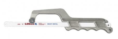

But for those squeamish about Plan A, there are several alternatives, depending on what you have for tools. A cheap and easy alternative is a tight space hacksaw. These come in many configurations. This will take a bit longer. But even this manual approach doesn't take all that long. There is an example pictured in the post above. Again, there is a video out there showing the poor guy taking forever with a hack saw. First, he uses a full size hacksaw handle, which is really too big for the space available. And I'm not sure what he was using for blades. But a good blade designed for metal, installed the right direction (hacksaw blades are directional) makes the job quite reasonable.
