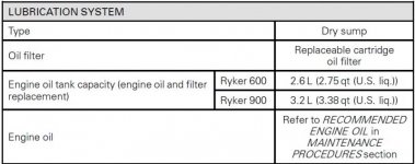

Engine oil capacity differences between 2019 & 2020?
SportsterDoc
For 900
The 2019 owner's manual (available on-line) indicates engine oil capacity as 3.2L (3.38 quarts)
The 2020 owner's manual indicates engine oil capacity as 2.8L (2.96 quarts)
Was there a change or is one of the manuals incorrect?
It is not winter, in the northern hemisphere, so this is NOT an oil thread!
Photos of manual attached for comparison.

This is going to blow your mind....My manual states Ryker 600 2.75qts. & Ryker 900 3.7 qts. I will stick to 3.7qts. This is from the manual that came with MY Ryker. At last CORRECT oil level check (unless that has changed also) ...Read label by fill funnel. My fill level was about 5/8 distance up the OK area. I think Amazon sells oil change kits with 3.5 qts. Maybe that's if you don't change the oil filter and clean the bottom of the canister, but who wouldn't do that? Better on low side than too full according to Shawn >>

Look at the pics again, and especially at top of the table in Sportster Doc's Pic 2 ;) The chart in Pic 1 is definitive, it states definite levels/quantities; BUT the chart in Pic 2 only details APPROXIMATE quantities; so I guess, after putting in the indicated 'approximate amount', you obviously just hafta use the 'best guess' method from there on in! :gaah:

2.6 liters or 2.75 quarts for 600 coincides with 2019 on-line manual.
But 2019 manual indicates 3.2 liters or 3.38 quarts for 900.
Previous research indicated 3 1/2 quarts for 900 ACE, but my 2020 manual is 2.8 L or 2.96 quarts.
For first oil change, it seems best to fill with 3 quarts, check level, then add.
Sportsters are dry sump, but oil bag is higher and level can be easily checked with oil bag dipstick. It will simply read a tad low, when cold.
With the Ryker, the admonishment of checking within 10 seconds of shutoff is not an exaggeration.

If the 2019 manual was correct for the Ryker 900 (3.38 quarts) and according to several posts, it is, then why did Can Am revise the 2020 manual to 2.96 quarts for the 900???
This is not about how to change the oil, it is asking why there is a difference between 2019 and 2020 Can Am manuals on an engine that does not appear to have changes.

The 2020 900 ACE took 3 quarts, yesterday, to bring level up to full mark on dipstick.
I took a photo, but oil too clear to show upon dipstick in that photo.
Double checked oil level after today's ride and it is at the full mark.
The one gallon milk jug contains what drained from the engine AND the transmission.
