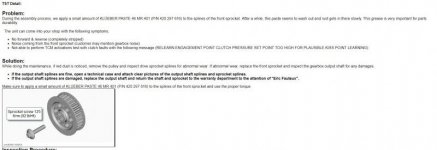

A local rider that required needing his front pulley replaced informed me that Can Am / BRP is not recommending Loctite in the TST and provided a copy of that info. Seems some have used Loctite, ours was lubed when assembled new and has no wear. Just sharing info, not saying what is correct or better.
The BRP recommended stuff apears Zinc based, not moly based.
