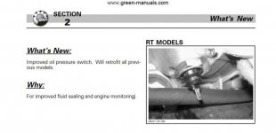

Well, I might just order a sending unit, I was wondering about the "LOW OIL" if it was low level or low pressure. Yes the engine is quite quiet and the message is erratic, its was there a couple of weeks ago and then I had done some maintenance and cleaned and tightened the battery connections and grounds and it was gone. Then today it was behaving and out on a short ride it began to go squirrelly. Thanks for all the replies and here's hoping!!!!
Just found this in the 2011 technical updates on the manual I downloaded. Improvements over the 2010 RT, think we might be on to something here! Where is a good place online to order this in Canada. part # 420256912​

Life is good again, I have oil pressure and lots of it!!! So I replaced the sending unit and cleared the "Low Oil" and Limp mode. And as a bonus it is the long weekend and maybe warm enough to ride here in the great white north.:yes:

Just an added note that I found on another thread. Initially I suspected the sending unit and replaced it. The "Low Oil" and Limp Mode remained, this scared the crap out of me. So off to buy an oil pressure tester (that part was easy) then to find an adapter M10 x 1.0 male to 1/8 NPT female. Found that and got it tested, pressure was about 50-60 PSI when cold and slowly dropped to 20-30 PSI when warmer at idle.
The big tip I found was to clear this "Low Oil" and Limp mode that is still hiding in the ECM from the bad sending unit. The RPMs must be brought up to 3000-3500 RPM for 20-30 seconds. There are other testing procedures in the Repair Manual but the first is to verify that you actually have oil pressure.
