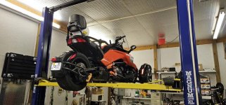

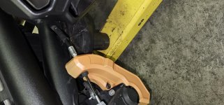

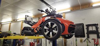

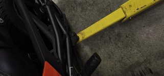

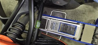

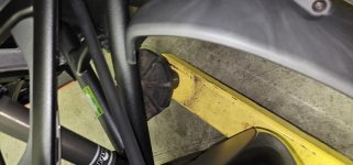

I got the Spyder on the lift this evening. It did require use of pad extensions, and a floor jack to get it onto the pads, but overall was a pretty easy task.

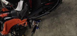

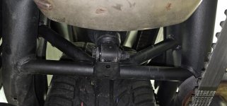

I placed a pad under each lower control arm, and under the swing arm on each side.
As always, and especially with an unfamiliar vehicle, I lifted it a couple inches, then tugged, rocked, pushed and shook it real good to make sure it was solidly supported.
The last thing I want is an accident causing damage, or worse injury.
Here are a few pics of how I lifted it, and I'm confident that it's secure, and on sturdy points that won't cause any damage.
BTW, anyone concerned about causing damage from jacking under the lower shock mount, I included a pic which shows just how beefy that mount is.

The problem you have with a 3-point lift is that if any one of those 3 lift points fail in any way, the Spyder/Ryker will just snap-roll over because it'll be so un-balanced. With a 4-point lift (like on a car) you have a better chance if you lose one lift point.
Whatever method you use to support your Spyder/Ryker off the ground, be it 6" or 6' high... please be safe & plan for the un-expected.
Cobranut, that’s fair comment for your particular model/year, but it must not be taken as a generality. Most other models do not have the cross beam beneath the shock, so you are jacking direct on the shock bolt. That’s why most BRP manuals say “do NOT place jack under the rear shock”. If you want to jack in that spot, you must place a block of timber (or similar) between the shock bolt and the jack to spread the load. ;)
Pete
