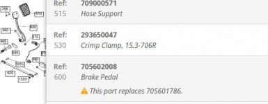

Double check the parts diagrams! When I look at the hydraulic brake parts diagram for the 2020 RT it shows the same number as for the 2023 with a notation that it replaces the ....1786 part.

The fit on the 2023 may have been some other change in configuration, say like the floorboard. Go back to the dealer and look at it more closely.

Looking at the parts diagrams again I see the Rocker, the shaft the pedal attaches to, has been changed since 2020. So maybe if you buy the rocker and pedal you can get what you you want.
