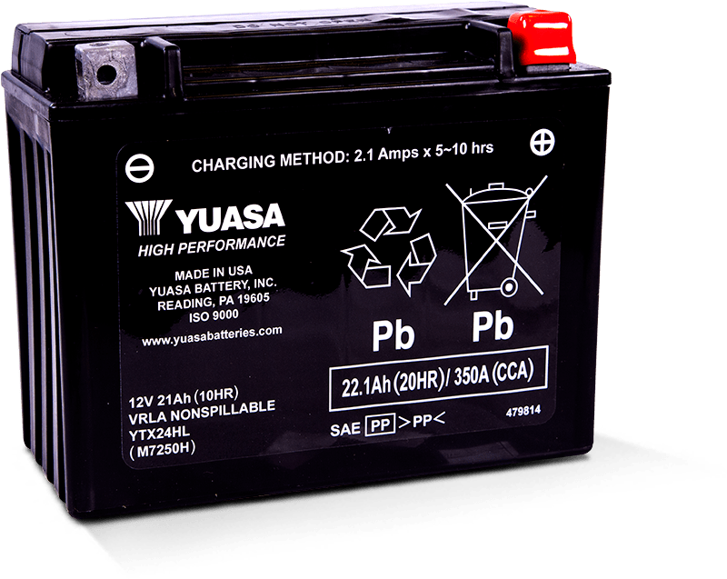

Yuasa YTX24HL. NOT the YTX24HL-BS. Big difference and the -BS is NOT RECOMMENDED by BRP due to charging system compatibility issues.
You want the factory activated one, not the -BS bottle supplied version.

From the Yuasa website:
YTX24HL - 21 amp hr, 350 CCA - recommended for 998cc Spyder (GS) 2008-2010
YTX24HL-BS - 21 amp hr, 350 cca - recommended for 998 cc Spyder (RS) 2008-2016, and for 1330cc Spyder (RT,F3) 2014-2022

The trouble is the initialization charge is very specific. Failure to do so or not doing it at all will lead to a very short battery life. The Spyder charging system WILL NOT initialize a new battery correctly. IF its all done correctly, the BS battery is fine. But most dealers and indeed most mechanics do not. This was BRPs reason for the tech service bulletin directing to use factory activated batteries only.
