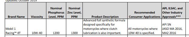

Per viewing the Mobil 1 and Castrol website, they say that they do not add Friction Modifiers to their 4T oil so as to Protect Wet Clutches. This is essentially the only major difference. so, if you want to glaze your friction clutches....rock on Rottella.

Have been using Rotella T4 conventional oil in 7 Motorcycles over the last 12+ years. Have already bought 2 gallons of T6 15w40 for use on the first oil change on the F3-S. Not saying it’s the best there is out there. Just saying that it has the correct specs, is (usually) readily available, and has never failed me in the years I have used it.
Rotella T6 5w40 does have a JASO clutch slip test rating of MA/MA2. But T6 15W40 does not have a JASO clutch slip rating in the specs. That I could find. I personally would not use the 15W40 without a MA2 rating.
PS: T6 0W40 does not have a JASO rating as well.
JASO MA2 is for cat equipped machines; JASO MA is for shared sump machines ..
JASO MA – This was the standard for single unit engines where the wet clutch, gearbox and engine used the same oil. JASO-MA oils don’t contain friction modifiers.

Pic of back label. Shows the 15w40 T6 is both MA and MA2 rated.
Well isn't that interesting. The online specs from shell's site does not list the 15W40 as JASO MA/M2. Several years ago I checked the jugs in the store. The 5W40 had the motorcycle symbol on the front label and the JASO MA/M2 on the back. The other 2 viscosities did not. Well now I have to check the jugs again in the Canadian stores.
It does here, from their website ..
https://rotella.shell.com/en_us/pro...tella-t6-15w-40-full-synthetic-motor-oil.html
SPECIFICATIONS AND APPROVALS Shell Rotella® T6 15W-40 API, CK-4, CJ-4, ACEA E9, JASO DH-2, MA/MA 2; Caterpillar ECF-2, ECF-3; Cummins CES 20086; DDC DFS 93K222; MB-Approval 228.31; Volvo VDS-4.5; Ford WSS-M2C171-F1; Allison TES 439, MAN 3775; MACK EOS-4.5
