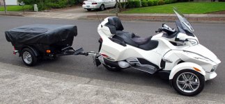

I think the microlite may be over weight after you get all your gear in it. I'm trailer poor and have tried everything except a teardrop and am thing about building one this winter once the riding season is over. When we want to camp I pull a Aspen trail-master knock-off and my bride pulls the dog trailer or the cargo trailer. My Aspen tops out at 420 pounds completely loaded including a box of firewood and I've put over 20,000 miles on it with two different Spyders , first a 998 now a triple. the 998 had no problem.

Yeah she'd most likley huff & puff a bit more but there's a guy that pulled a Little Guy Deuce coast to coast with his 998. When I was on the hunt for a trailer I actually got to speak with him and he said it pulled just fine. Now, the Deuce was discontinued so no option there and it was heavier than the Twist.
I believe all manufactures leave a little wiggle room with specs, least that's what I tell myself rolling down the highway at 70 MPH.:D

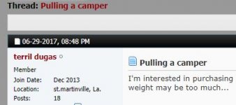

Hey folks, I think we are talking to ourselves here. Terril posted this on 6/29 and has not responded to anything since.
You are welcome Terril Dugas, so glad I could help you out, no worries!
