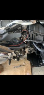

2008 GS - did the canisterectomy last night, ran the vent line up from the tank, certainly higher than the tank itself, then back down along the right side to the rear just like I see people doing on a couple of videos and posts. But I now have a lot of fuel smell from the rear of the bike, and after the ride today it was dripping gas onto my floor, and I could smell gas the whole ride when stopped. Not very thrilled about that. Is something else going on or is this normal after a canister delete?
If so, I would rather leave the canister in place and get a new purge valve. Rather than have gas dripping on my garage floor every time I ride it.
Also, I can hear what sounds like the gas boiling a bit after the ride....
