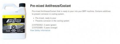

So, XPS Orange. Got it, thanks. https://www.amazon.com/Ski-Doo-Sea-...9Y2xpY2tSZWRpcmVjdCZkb05vdExvZ0NsaWNrPXRydWU=
This is the description per Can-Am of the XPS coolant (they don't give the generic specs, because I guess they don't want us buying cheaper substitutes);
Providing protection from freezing or overheating, our Extended-Life Pre-Mixed Coolant is easy to use as it contains the correct dilution and necessary additives for your engine. Also designed to prevent corrosion and to inhibit cavitation in cooling systems, the long-life 5-year (orange) formula offers superior heat transfer and is specifically formulated for vehicles. Spend less time working on your vehicle and more time enjoying it! This XPS Extended-Life Pre-Mixed Coolant is the ideal replacement for vehicles that normally use a 2-year antifreeze/coolant (green).
More Information
Features Description Antifreeze/Coolant contains the correct dilution and the necessary additives to prevent corrosion and inhibit cavitation in BRP cooling systems. Long-life, 5-year formula specially formulated for BRP vehicles. Superior heat transfer. Ideal replacement for vehicles that normally use a 2-year antifreeze/coolant (green). 5 years (orange).
