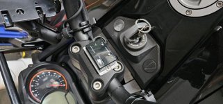

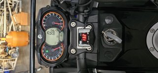

Pics of my gauge installation.
I don't particularly like digital gauges, but I wanted something unobtrusive. This one is inexpensive, water resistant, and looks decent on the bike.
I milled a flat spot on the handlebar mount, drilled and tapped countersunk holes and used flathead SS screws to attach an aluminum plate.
The gauge mounts with 3M tape.
I checked the gauge before installation, and it's generally within 2-3 psi. It works well, and it allows me to see any changes over time. :thumbup:

Another member asked about this, so here are links to the parts I used.
https://order.ebay.com/ord/show?orderId=20-12191-56960&purchaseOrderId=20-1219-156959#/
https://www.amazon.com/dp/B0CT8S9XFJ?ref=ppx_yo2ov_dt_b_fed_asin_title
The transducer mounts in the oil pressure test port at the front right of the engine. Route the wire to keep it away from exhaust heat. I coiled up and secured the excess just behind the right fog light.
Be aware, you'll spill several ounces of oil when installing, so have a pan ready, and check your oil level afterwards.
For power, I used the customer accessory circuit, which isn't active until you crank the engine.
I like the gauge, and it's really handy to tell when the oil temperature is up enough to use higher rpm.
