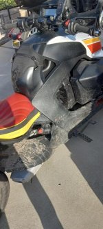

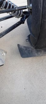

Took the Rykers out today. The dirt roads were quite muddy and wet. It’s now time to shorten the front fenders. Broke the little wing on the bottom of the fender. Those things are quite low for off road and don’t really help keep water off you. I’ll post some photos after I cut them.

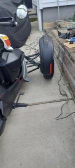

Let’s try this again. Don’t know what happened to that earlier photo.
That looks just fine, good job! Let us know how it works. You could always extend it with a rubber mud flap if you need a bit more coverage.
