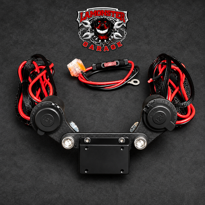

I'm looking at adding the GPS Mount and Dual Power block from Lamonster (see link below) using the 12v socket for running my heated gear. Does that sound reasonable (I'm new to Spyders so I'm guessing here)?
