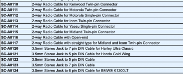

PaladinLV,
I am looking for a CB to use with the Sena SR10.
From your write up I am getting that you are using the same cord from the Sena to the Cobra that you used with the Midland. Is that correct? I am trying to figure out if the Midland cord from Sena will work with the Cobra CB.

SENA does NOT make the connecting cable for the Cobra.ere is a list of the available cables for use with the SR10

Did Cobra supply the cable that hooks up with the SR10 ???? SENA don't make them unless one of these work
please
Dave
The difference of the 2 pin cables is NOT the pinouts, but whether the MIC/SPK connection are STRAIGHT or 90 degree angled depending on the Radio layout as the MIC/SPK connections have been pretty much standardized years ago with the advent of Ham radio HHs.
Cobra being smarter than others can use EITHER. In fact with the Cobra, ALL those TWO PIN connectors will most likely work, but DEFINITELY works with Midland and Icom.
