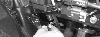

I have a 2018 F3T and I am going to fit the BRP signature light

Looking at the BRP instructions it shows the Accent Light Harness plugging into a LHS
Vehicle accessory connector (looking from the front of the Spyder)
The instructions state plug the Accent light harness into the Vehicle
accessory connector
See photo below
I have the Customer accessories wiring on the RHS
I don’t know if I have have the LHS vehicle accessory connector and I wondered if I could use that Customer accessories wiring on the RHS
I’ve checked various owners manuals and none mention the vehicle accessory connector only
the customer accessory wiring
Any information would be helpful
:dontknow: Hopefully just a orientation description issue What side is R/L looking at or sitting on. Unfortunately no defaults & varies with just about anyone you talk to. Thankfully no cutting/splicing wires required. If connection fits proper may cautiously try testing. :dontknow::popcorn:Up to you & comfort level. ** nothing about N American harness?**
Just removed my funk there doesn’t appear to be the Vehicle accessory connector on the LHS (standing at the front of the Spyder looking towards the rear) the only connector there already has a plug in with wires coming from it
I will use the RHS customer accessory circuit (standing at the front of the Spyder looking towards the rear)
